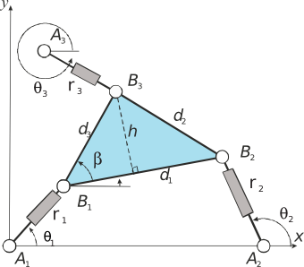

Parallel_3RPR
Parallel_3RPR := proc({
d1 ::algebraic := 17.04,
d2 ::algebraic := 16.54,
d3 ::algebraic := 20.84,
beta ::algebraic := arccos ((d2^2-d3^2-d1^2)/(-2*d3*d1)),
A2x ::algebraic := 15.91,
A3x ::algebraic := 0,
A3y ::algebraic := 10,
precision ::integer := 4
morespec ::seq(name=algebraic),
moreranges ::seq(name=range)  )
Constructs the Manipulator object of a planar 3-R P R manipulator.
Parameters
name = constantthe geometric parameters of the robot (see Figure1),
Figure1
  • where name is one of d1, d2, d3, beta, A2x, A3x, A3y,
  • and constant is a numerical value.
  • All the variables d1, d3, A2x, A3x, A3y must be assigned.
  • One of d2, beta must be assigned (if both are assigned, d3 is ignored).
  • By default, the values are d1 = 17.04, d2 = 16.54, d3 = 20.84, A2x = 15.91, A3x = 0, A3y = 10.

Parallel_3RPR_full
Parallel_3RPR_full := proc(morespec ::seq(name=algebraic),
precision := 4 )
Parameters
Figure1
precision = integer (optional)the precision, where integer is the number of significative digits; default value: 4.
Returns
A Manipulator data structure representing the planar 3-R P R manipulator whose dimensions are given in input.
